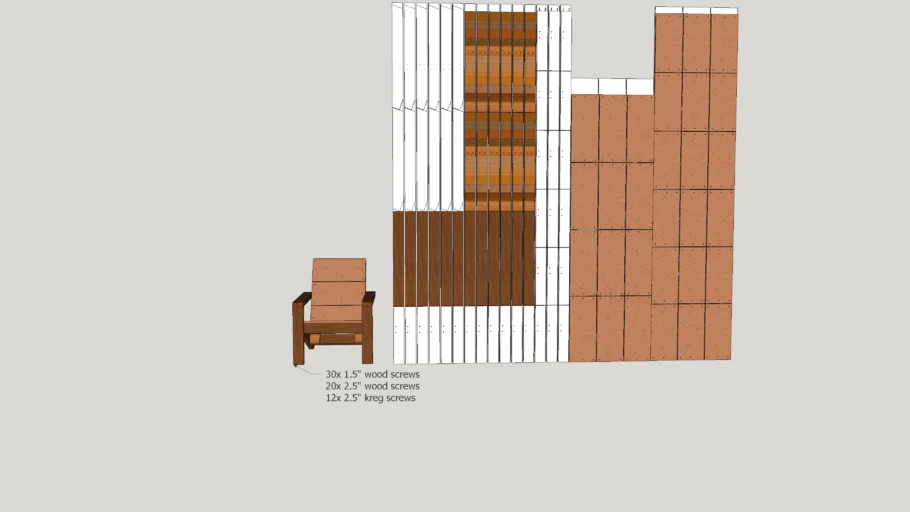

Just made 6 of them for my yard. Look awesome. Check "The BEST Adirondack Chair Plans!" video on YouTube by Ana White for assembly instructions. Made couple little changes in my build, both of course optional (made a 20 degree cut in the front piece on the table saw to get rid of the gap on top and used Pocket Holes to attach armrests to front legs to get rid of screws on top of handles). At the end I run a roundover bit in my router on top of the handles and front piece of the seat to get rid of sharp edges and make it more enjoyable. Then sanded and finished with Stain/Sealer to protect from elements. Not gonna recommend the one I used, since I dont know how it will hold over time. I am in Florida so it would be put to a good test of time. :) Highly recommended. Easy to make and very useful.
